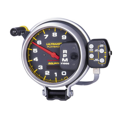

Although one can work with trial and error, the best route is to use some type of data collection that records the motor and driveshaft RPM's to determine slippage. I will probably be adding this dual playback tach prior to getting aggressive with my clutch adjustments. It comes complete with a driveshaft sensor:
http://static.summitracing.com/globa...e/atm-6881.jpg
