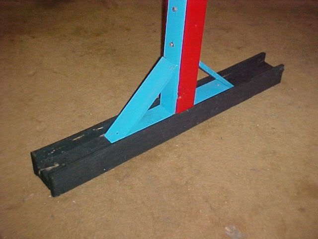

This first JPG is of one of the bases.
The bases are Black, and are made of "I" beams made of 1.5" marine plywood with .75" marine plywood flanges. They have caster wheels at each end. The bracing is Process Blue 1 X 4s, and hold the Red uprights, which are "I" beams made with 2 X 4 webs, and 1 X 4 flanges. The Red uprights are held to the Black bases by the Blue bracing, and the assembly is held together with Carriage Bolts, and Wing Nuts.

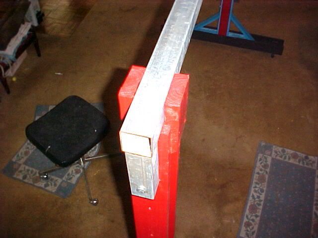

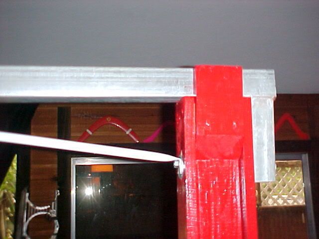

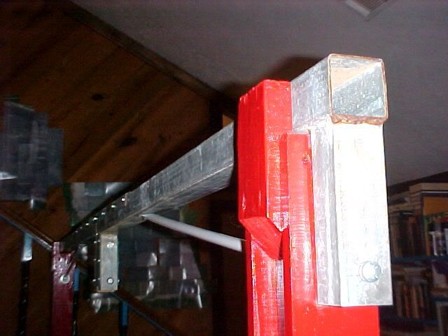

The next four JPGs are of the connection of the 10.-0" wide Top Beam, Cross Bar, which is 2.25" X 2.25" X .25" thick wall square tubing which is held to the Red uprights by Carriage Bolts, and 7/8" tubing braces. All connections are held in place with Carriage Bolts and Wing Nuts.

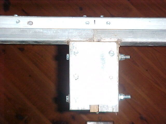

This last JPG is of the connection in the middle of the Square Tube Cross Beam. The Square tubing was two 5'-0" pieces with square tubing 90 degree pieces welded to each end of the 5'-0" long pieces. They are held together with 9/16" bolts, sheet metal covers, and .75" X .75" Angle Iron reinforcing.
