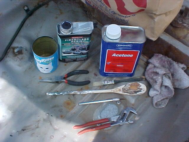

This first JPG is all the stuff that you are going to need: From bottom to top:
A pair of pliers to get the caps off of the cans.
A No.11 Exacto knife to punch the hole in the catalyst tube.
A wooden spoon (use the handle to mix the resin and catalyst).
An inexpensive small brush to paint on the resin and catalyst.
A pair of needle nose pliers to punch holes in the can of Acetone that is used to clean the resin and catalyst out of the brush.
A tin can in which to mix the resin and catalyst.
A can of resin, and on top of it is the tube of catalyst.
A can of Acetone to clean the brush.
and a rag to dry the brush after it is cleaned.

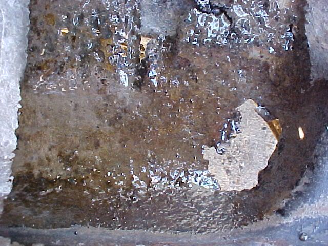

This next JPG is of the rusted area to be repaired after it has been liberally coated many times with Phosphoric Acid which turns the Iron Oxide (rust) into Iron Phosphate, which is harder than Sapphire.
This next JPG is of the area to be repaired after it has been liberally coated with a layer of resin and catalyst. It is curing, EVEN as I am typing, and I'm doing this post so as to have something to do while it does THAT! I've also got the passenger's side coated with resin and catalyst, but to do the tutorial about how to do this, it is not necessary to show THAT side too.
This is where the project stands at the moment.

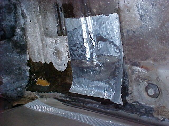

I just finished putting in the first two layers of aluminum and the second and third layers of epoxy resin.
I then took the JPG seen below.
While working with the aluminum, I found that one has about ten minutes in which to press the aluminum into the epoxy before the epoxy gets too viscous with which to deal. BUT with a piece of cloth, rubbing on the aluminum makes it to where it conforms, and molds to the contours of the floor below. One has to be careful while working over the actual holes to keep from tearing through the foil, but once the first layer of aluminum is in, the forming of the second layer feels just like there is solid metal below where the hole is.
I'm making each succeeding layer of aluminum about 1/8" larger than the last one so that there is no build up a ridge. The larger sheet of aluminum then fits flush against the metal of the floor pan.
Another thing that I've found is that one doesn't have to wait till the resin is cured to continue the aluminum laminate build up.
Hey Guys! I think that this may just work GREAT. Only time will tell if the aluminum won't adhere to the epoxy. If it does, this is a pretty neat fix for holes rusted in the floor!

Never know, but the edges where the epoxy escapes the foil sandwich might also help to keep the layers from seperating. Being under carpet once you are done will help with the longevity if it works out well for ya.
