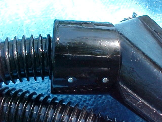

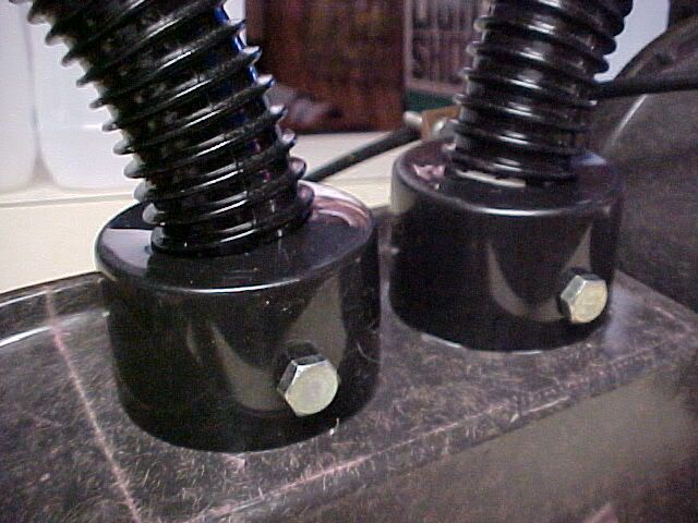

BUT, I do have a couple more JPGs of the Defroster Hose.
This first JPG is of the connection of the Rattle Can Cap to the Fibrous Funnels using the cute little screws:
And this JPG is of the Rattle Can Caps connected to the Heater/Defroster Plenum Outlets with these humongous bolts. The bolts are only about 1/2" long, and the reason that they are so big is NOT because they need the strength. It's because the hole in flange of the outlets from the Plenum are about 9/32", and the bolts that I used fit perfectly, making their own threads as I turned them in.
