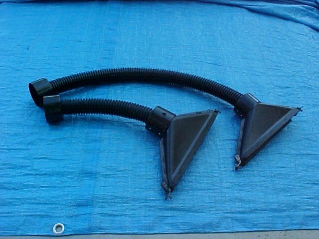

Here is the first JPG of the Heater/Defroster Unit's new Defroster Funnels, hoses and connectors.
Those are the original Fibrous Material Funnels. The hoses are from an old Shop Vacuum. The way that the Shop Vac Hoses are connected is by attaching each end of the hose to a Rattle-Can Cap that has a hole cut in the top of it that fits the smaller diameter of the "finned" (for flexibility) Hose.
The Rattle-Can Caps are then attached to the Fibrous Material Funnels with four (on each cap) of the cutest little teenincy screws screwed through the Rattle-Can Cap and into the flange edges of the Funnels.
the other ends of the Shop Vac Hoses and Rattle-Can Caps fit over the outlets on the Plenum Chamber of the H/D U, and are attached with a large diameter (but short) screw that goes through a hole in the Plenum Chamber Outlet Flange.
Cost to do this:
Funnels: $0.00
Rattle-Can Caps: $0.00
Shop Vacuum Hose: $0.00
Black Valspar Plastic Paint: $1.00 (approx)
These units are superior to the original units in that they are sturdier.
