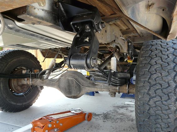

1 1978 Ford F-150 rear suspension pictures, videos, and sounds | SuperMotors.net - Changed the rear springs to chevy 64", which moved the axle back 3" and moved the front spring hanger forward 4". This gave me better shackle angle and hopefully better suspension travel when I change to Deaver F70's somewhere in the future. And I need a local fab shop to make some traction devices as the springs are beginning to bend from the torquey engine.
