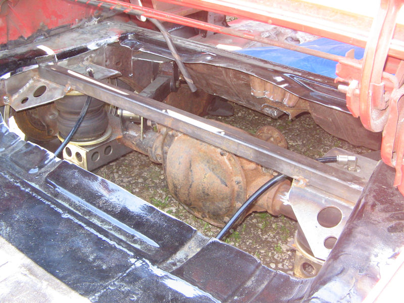

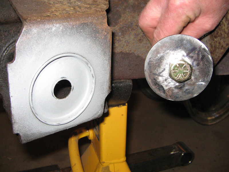

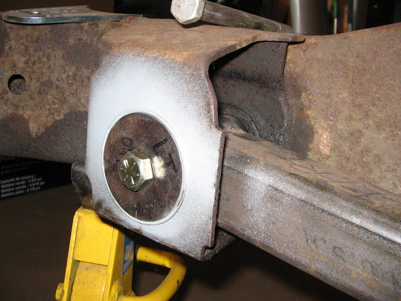

everything is tacked together, but i forgot my camera out in the country.
so here is some mock up photos.

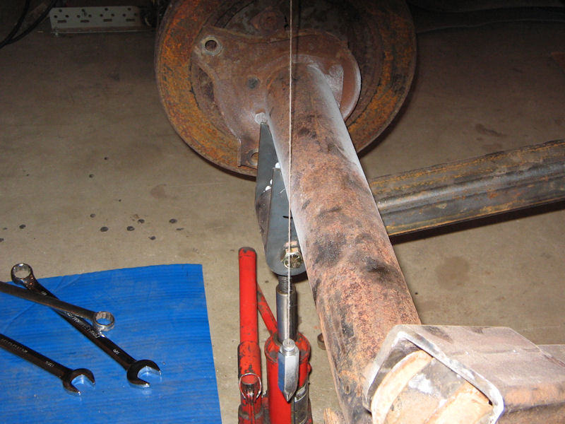

lined up the rear end
grinded down the ridge so that the circle would fit flush
placed circle in place, and through a bolt throught to make sure it doesnt bind. still need to weld the circle in place
made sure everything was centered
mocked the 4link tab, and bag mount in place
everything tacked into place
♠♠ MaxwellKustoms.com - Those who know dont talk, and those who talk dont know. ♠♠

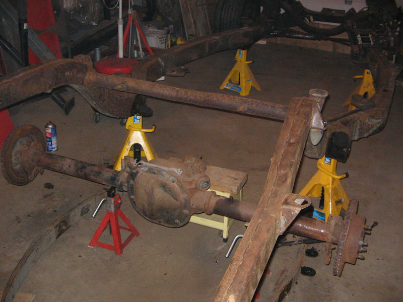

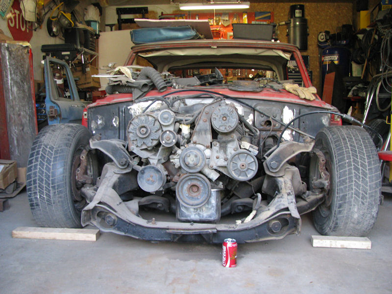

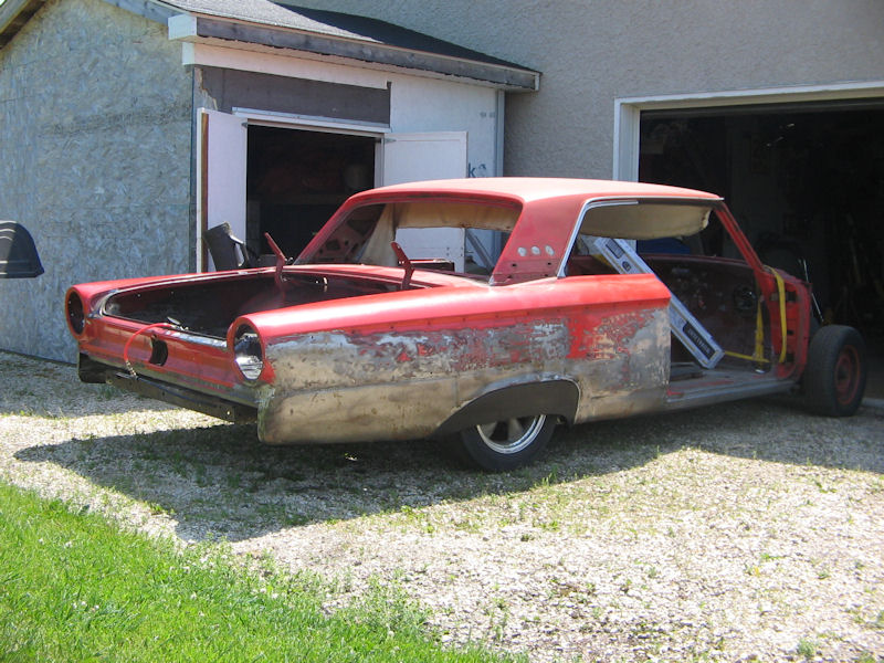

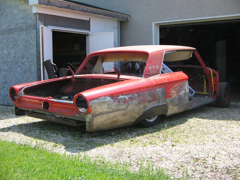

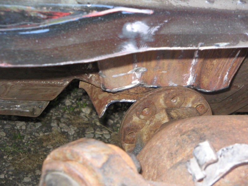

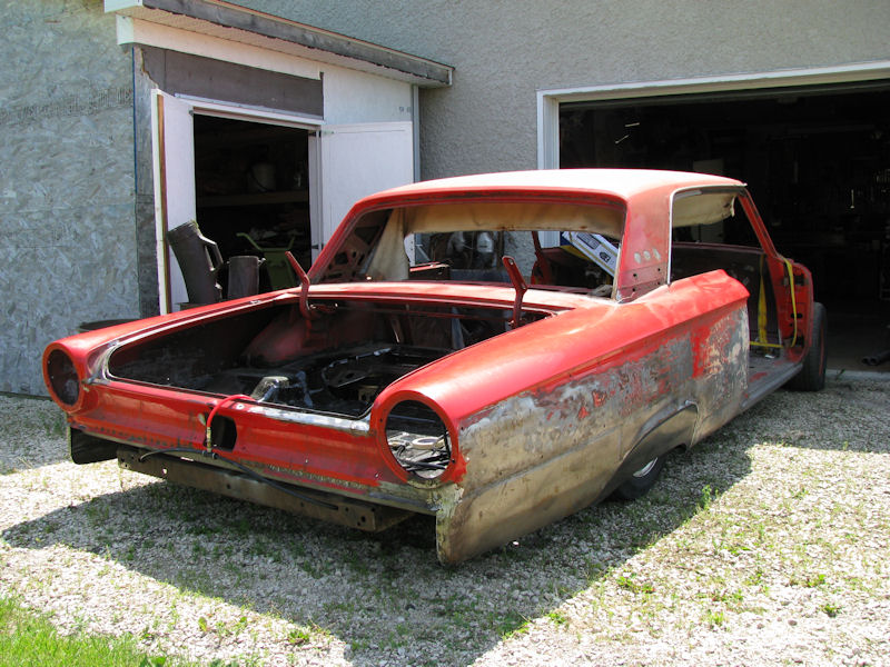

so now that the 4link it tacked, we put the body back on the frame to see how it fits. turns out i need to raise the trunk floor where it dipped
cut the floor out where it needs to be raised
car at ride height.
car sacked out in the rear.
the gf taking some pics. she has a way better camera, but we would be still waiting this time next year for her to upload them :nut
oh yeah can anyone guess what I am doing tomorrow?

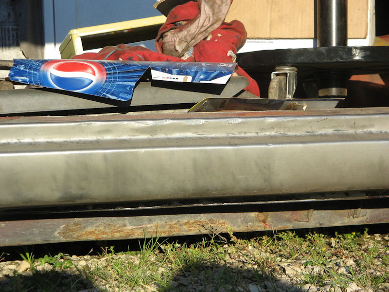

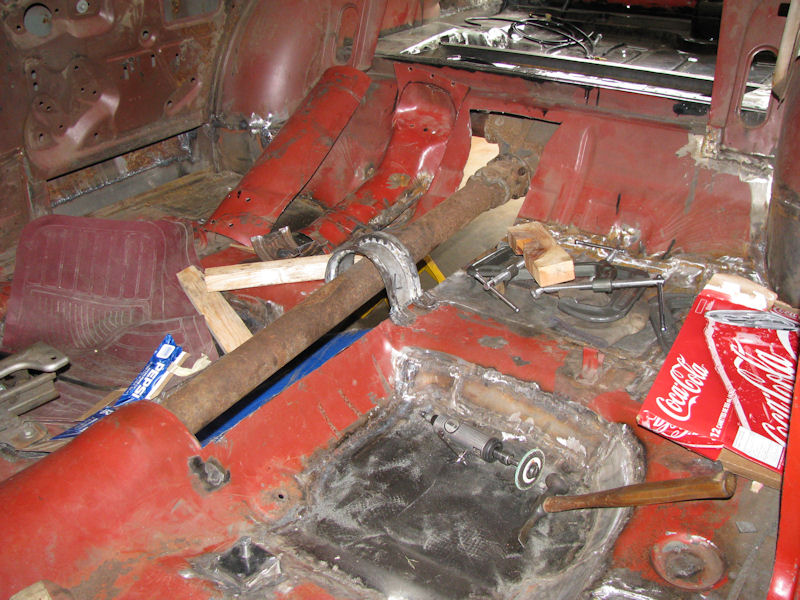

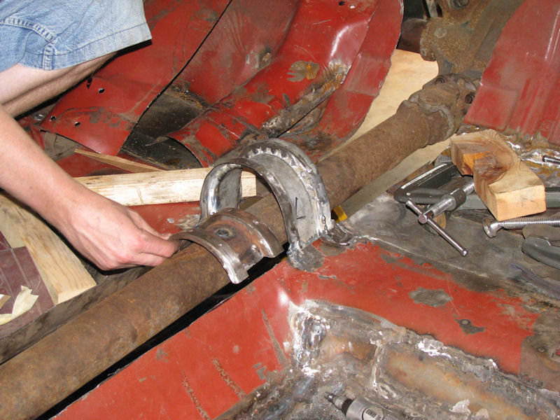

made a new brace for the floors since the last one would hit the drive shaft
just a shot comparing the new with the old

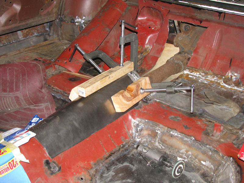

forming the new tunnel
just tacked, more work needed next week to finish it up

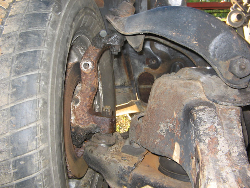

Installed a set of spindles + discs off a 79 tbird. Thanks Luke. Still need to paint, and clean up.
Shot of the front end when the bags are fully deflated.
Frame clearance of 1" or less when it is layed out now.
