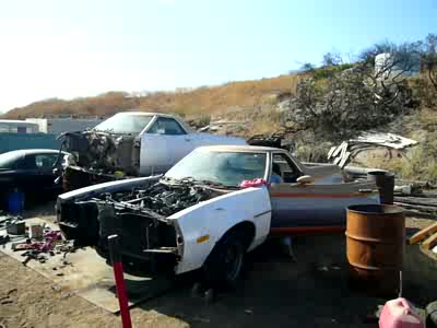

Re: Rebirth of a Ranchero
Ladys and Gentlemen. It's Alive! Click image to see movie.
Great job. Can't wait to see it pull out of there under it's own power too.
Pretty cool to see that a female was actually enthused about the achievement. 72-76 torinos/rancheros were never known as babe magents. Sadly, I think mine served as repellant for many years.
Hey, you should have auditioned for the AutoZone commercial. Come on, just say.... "It basically took me the whole summer"
Thanks Mike. I have already done a test run. Still needs alot of work but she at least moves now. Gonna get the rest of the front back on next weekend and hopefully get her down to town for the exhauste and a really good bleed on the brakes.
The woman was my friends dads girlfriend. Sge thinks these are teh greats cars ever.
On the auto zone. I loath even thinking about going in there down where I live. I have beter customer service at Pepboys and Carquest and NAPA. So those are the 3 places I go for parts. Now outside of California than heck ya I would go to Autozone but never in Cali.
Oh and how did you get the video to imbed in the webpage like that?
