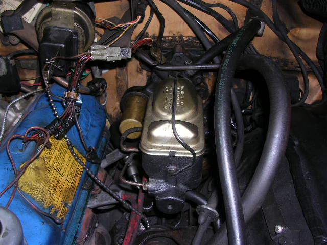

You can grab the rear disc brakes off a 77-79 Lincoln MK. The same car should have a hydro booster system. That is the only factory brake booster besides the Vacume booster.
NOt a good pic but it shows the hydraulic booster.
